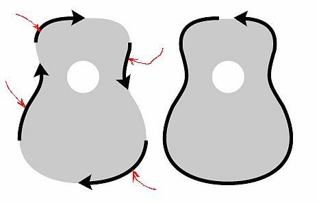

Anti Clockwise is a normal cut, but it helps to climb cut certain areas to avoid tearout, if you go to stewmacs site and bring up the instruction for their kit it has a great diagram that illustrates the climb cut positions.
with a bearing cutter I'd cut the puflings first as the bearing needs the binding area intact to index off.

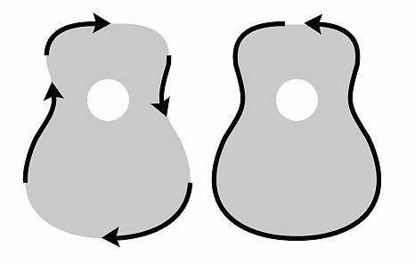

PostPosted: Wed Apr 19, 2006 10:09 am
Hi Rich
This is the diagram I was talking about.
Todd

Whenever you have compound curves, as in a guitar body, to avoid chip-out it's best to route from side-grain DOWN to end-grain. So, as the above diagram shows, you'll start at the widest part of the upper and lower bouts, where the side-grain is, and move down into what becomes end-grain. Now, the narrowest part of the waist is also side-grain, but if you start there, you'll be moving UP into end-grain, and that means chip-out! Remember, always side-grain DOWN to end-grain.
BTW, the first diagram illustration (the climb-cuts) is suggested as your first cuts, followed by a continuous counter-clockwise route around the whole body.
WARNING!!! This is very important! Climb-cuts are potentially dangerous. The router LOVES climb-cuts; it wants to marry climb-cuts and bear its children. Climb-cuts offer the least resistance to the router, and it can then easily get out of your control and ruin your work or your body parts! Use your mightiest concentration, always, when climb-cutting!!!
